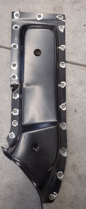

That should be a reasonably easy repair. I'd use a replacement floor pan part and use only what's needed from it.
Parts like this are what I'd use. A floor pan section and a seat mount and you are in business.

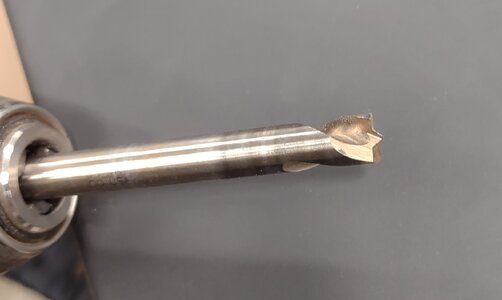

You need a spotweld cutter and some inserts, drill motor, etc.

If you can weld and are decent at fabrication you can absolutely handle this. Agree with Chuck. Drill out spot welds and remove seat mount bracket, then make patch or buy replacement pan. I have a tough time cutting an entire floor pan for a small rust area. Check for pin holes through out the floor.

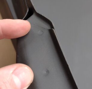

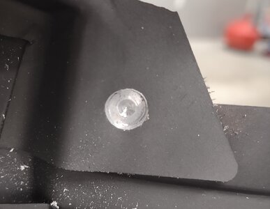

Here are some pics of spot weld bit. And what it looks like using. You only trill deep enough to break the weld, try not to go through bottom layer. Then take a slap stick and break the weld by wedging between bracket and floor. Seat bracket will pop right off. This is not Turbo Buick stuff but same concept:)
