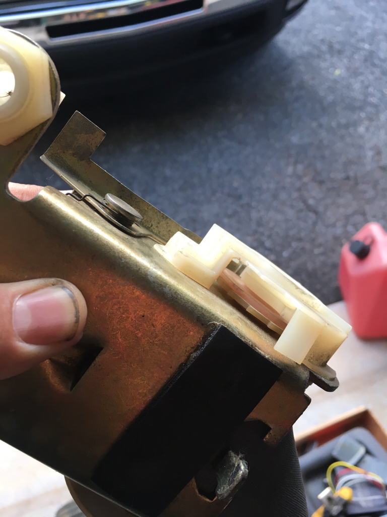

Today I decided to take the mechanism apart. Only the side which I could see the gear teeth. The other side says "Caution, Do Not Remove". I think it's because that's the side with the spring which winds up the belt. I could see that the sheet metal cover has a tab which holds the plastic cover on. See in the following picture.

Then I used the small screwdriver to pry the sheet metal cover off. I pried next to the two tabs (left and right) at the bottom of the cover. The mechanism is upside down in the picture below. The sheet metal cover pops right off. Then you swing the cover up and off the housing.
Looking at the inside, I could see three places where the plastic cover goes into holes of the metal housing. It almost looks like a plastic screw, but it's not. I found out after getting the cover off that the slot allows the plastic to squeeze together and pop out of the hole. The slot in the plastic, in the hole, is shown below.
I carefully slid my small screwdriver between the plastic cover and the metal housing. I only had to push it in between. I didn't have to pry on the plastic. The screwdriver is very thin, and it wedged the plastic cover off the metal housing.
I had to repeat this in two more locations to get the cover off. I kept my hand around the housing and cover, and it's a good thing that I did. There's a spring under the cover, so you have to take the cover off slowly so you don't lose the spring. It's a light spring, so it's safe to take off. You just don't want to lose the spring.

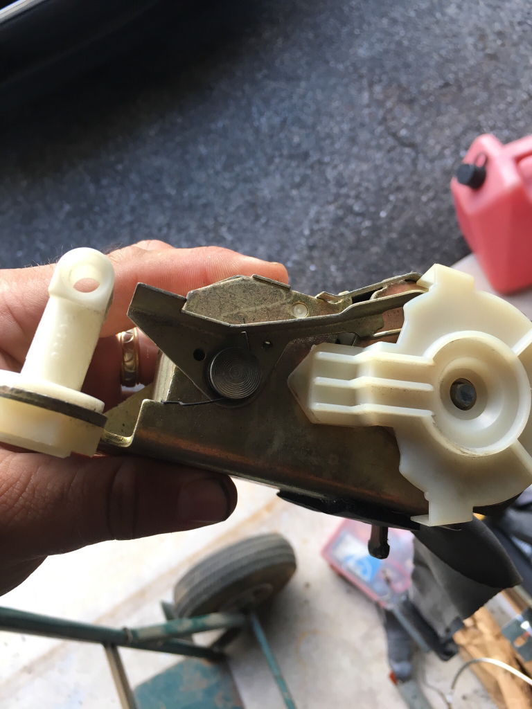

Below is another location to pry the cover off, and then a picture of the cover off and the spring exposed.
The parts under the cover some off easily. See below.
After taking off the yellow sprocket, I found the problem. The hole of the plastic sprocket is stripped. It's supposed to have a pentagon shape to match the shaft, but it was almost completely round. I put it back on and it would skip over the flats of the shaft. In the picture below, you can see black in the hole where the flats of the pentagon should be.
So off to the junkyard. I could not find the exact seat belt assembly, but I found one which I could take apart and pull out the sprocket and install it into my assembly. After putting everything back together, the seat belt works just like it should. Problem solved. :-)
