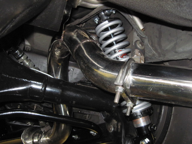

What did you use to lower the rear?
Initially I used Hotchkis F body lowering springs which I trimmed a bit to get to the height I wanted. Last fall I went to the coilover shocks that we sell. Makes it a lot easier to get the exact height that you want vs trimming springs down and hoping you didn't go too far or not far enough. http://buickgn.com/gbodyrearcoiloverkits.htm
