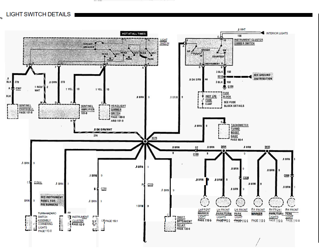

If the tail lights are not working the parking lights in the front and the dash lights may not work as well. Here is the circuit from the service manual:
No, Its like its jammed closed and ou have to press it real hard or stamp on it for it to go down. The idel appears ok but alittle high. The tps is at .42 and no SES light. I have to adjust the AIC to lower the idle which I will probably have to readjust the tps but I dont think that would make the peddle stick. As for that schematic, Im a electrician but very rusty with them but I do not see anything in that schematic that shows the tail lights unless that tail going toward the bottom is to the tail lights. If thats the case then the tail lights are part of the light switch and shouldnt have anything to do with the ignition switch as I thought they might. Am I correct?
