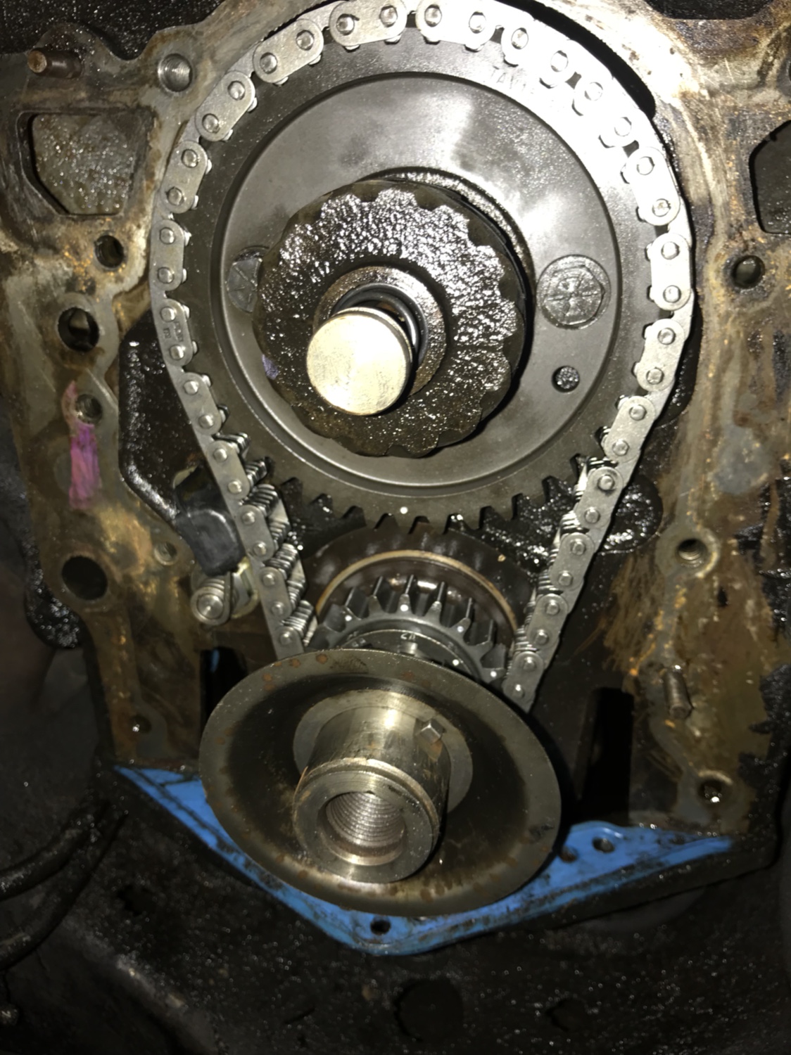

I have one of the ta performance silent timing chain sets from ta performance and am wondering the proper way to install I’ve got it all on but am confused on how to line up the dots. I have a stock untouched motor. As of right now I’m lining up 0* on the keyway but I want to make sure this is correct before I put it all back together. Thank you guys for any help.

It looks right if the dots are lined up you should be good to go with no retard or advance
