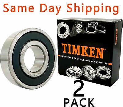

I used this one and got the correct belt size so it operates in the correct area of the tensioner. Been nice and quite for a couple if thousand miles so far.
Is it worth waiting for the timken or just go local for the duralast? And what is the "correct" belt size? Thanks for the help.
Use whatever makes you sleep good at night. Belt depends on your pulley setup. My car is all stock and I used a NAPA 060630 6PK1601 belt.
Myself, I prefer Timken bearings but that's just me.
