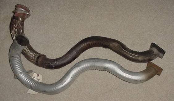

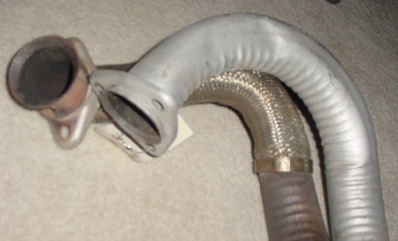

I have a 1983 Turbo Buick Regal. This is the early carbureted version. I and others are very interested in a larger 2½" downpipe. I have heard reports that you make a very nice 2½" DP for the 84/85 Turbo Regal, was hoping you would consider making one for the earlier cars. The downpipes are very similar. Only the top portion is different and it is actually less complicated than the 84/85 DP.
Dowpipes interchange for all 1978 thru 1983 Turbo Buicks except Rivieras (FWD). I know there would seem to be very little demand for early Turbo Buick performance parts, but I believe that quite a few people would be interested in this. The small stock downpipe is one of our primary week spots.
Here are some comparison pictures. I can send you an stock downpipe if it helps.
Overall dowpipes (83 is silver, 84/85 has braided top)
Close up of top section
