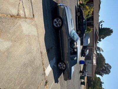

Finally finished the Viking Coil Over and suspension install.
I have 18" wheels and am adjusting the height.
I've had multiple settings but not quite sure if anybody has done same.
Advise or your setup that worked perfect?
I attached pics of way it is now.
seems a bit low
lmk

Try parking on level ground first

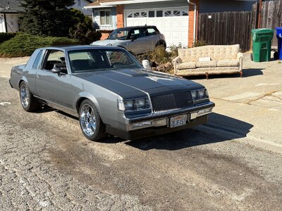

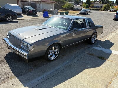

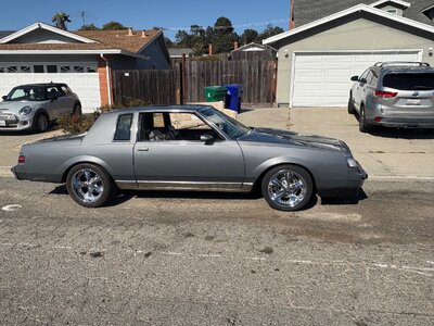

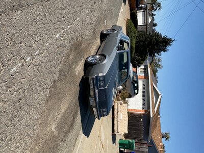

Got her back to cruising again. Dont know if i like the raked look. What you guys think? I had taller tire in front but rubbed just slightly on one side so I got 235/40/18 instead of 245/45/18 and its perfect. Ride feels great.

Im personally not a fan of the rake on these cars....if you like the ride, run it for a while and see if it grows on you or not.....Also, Is the couch in the background still available?

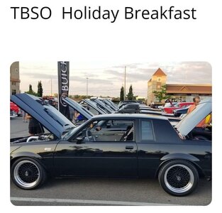

Here’s my car with QA-1 single adjustable coil overs front & rear. 18” x 8” fronts with 245-40ZR18’s , UMI tubular control arms (upper & lower) 550# Viking Springs ,
18” x 9” rears with 275-40ZR18’s , HR Parts N Stiff control arms (upper & lower), 150# rear springs
UMI Pro rear sway bar with end links
BF Goodrich G Force Sport Comp II’s F&R.
