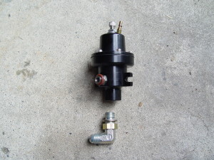

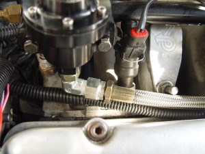

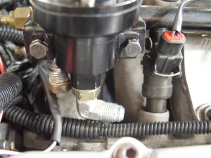

I'm just trying to get an understanding b/c I'm trying to do this. Here's an example of my motor. See the fuel filter follow the line up which screws into the bottom of the regulator. Now from reading I would unscrew the line and add .....
I add this so that I can connect to the braided return line....
This will return to the gas tank.....What about the fuel filter and the line is it dead now....Want I still need my fuel filter?

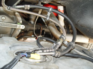

Braided return line runs to middle port on gas tank....I'm I getting the 87 mixed up from the 85 or is this process the same??
look closer at the picture the line from the fuel filter crosses in front of line that goes to regulator to the right then to the fuel rail
all correct except the the fuel filter part......line from the frame on driver side goes to fuel filter.... then to passenger side of fuel rail..... then the line from the regulator goes to frame and back to the tank

I took both lines down driver side to tank. Not sure of length. I purchased a complete kit from racetronix. Including a relocated fuel filter in the 87 location I would guess measure from front of engine to front if tank add 1/2 width of car
Take a 3/8" air hose and route it through the car in the approximate path you want it to run, band it with masking tape at the proper ends. Then pull it out of the car, stretch it flat on the floor and measure.
