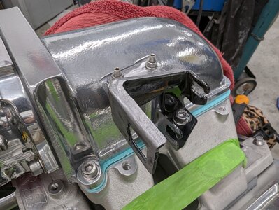

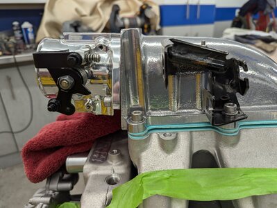

If I understand what you are trying to accomplish.... Get a stock one and fabricate it. You can get the geometry correct and keep it from sitting way to high.

that's exactly what i'm doing.
wanted to fab another one while still
running car.
thanks for the pics!!
That's what i had in my mind.
I had a thread a while back i was looking
for what people did but never got any pics of the mod.
looks like you cut the original top of doghouse tab and welded up higher.
Mine didn't look like it would bolt on bottom and clear doghouse by eyeing it, but i guess it does.
My buddy powdercoats so it will look good
thanks again

That exactly what I did. Cut that upper tab off, mock it all up, then tack weld it while on the engine. Remove and weld it up. And yes, powder coat afterwards.
