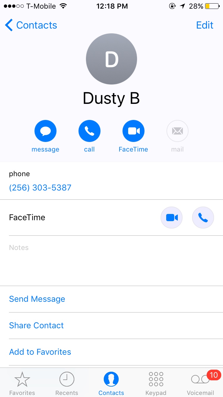

Does anyone have a current working contact number for Dusty Bradford So I can order this New converter that’s needed. Thanks

Just called him a couple weeks ago
