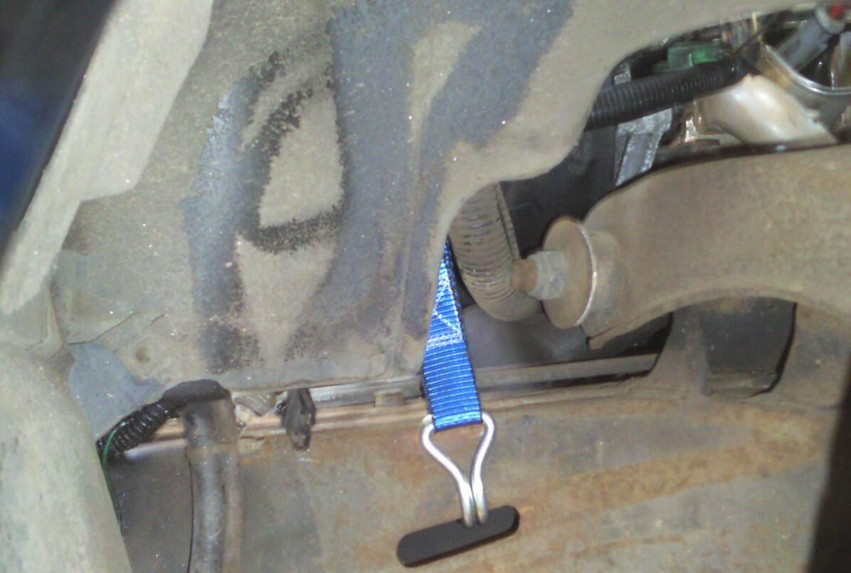

Does anyone have any detailed pics showing the location in the frame where the strap attaches? Does anything need to be moved or removed to allow clearance for the strap? Thanks in advance.
Don't have a pic but it goes in the slot in the frame behind the front wheel. Shouldn't need to move anything for the strap to clear.

That's what I'm referring to, I know it connects to an eyelet at the alternator, I just wasn't sure where exactly the frame side secured
http://www.ebay.com/itm/221608628378
That's where I hooked it up, thanks for the pic Earl.
How tight do I want to make it? I obviously don't want to stress out the eyelet or risk snapping the tensioner ear off.
I usually go '1 click' as soon as I see it pull snug. It'll take a set once or twice until the fibers find their happy place. You don't want it to do the job of the motor mount, just give it some extra support when it's loaded with torque.
