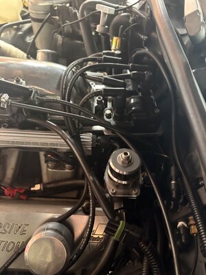

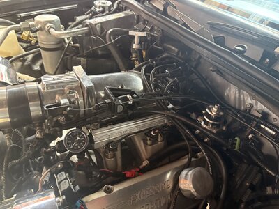

How is the coil pack mounted ?
Manual version 1.1 picture on front of installation manual has #1 bottom right. (Drivers side) 5-2 facing firewall 1-4-3-6 forward. Weather pack coil passenger side Tr6 weather pack drivers side
Bobs website show #1 top left (passenger side) 5-2 forward 1-4-3-6 firewall. Both weather packs facing drives side.
Yes Chevy and Buick have the same hiring order So it must not matter?Or dose it.

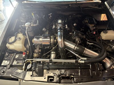

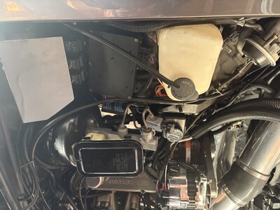

Mounted mine on fender for now, will put in cab next time. I wouldn't put on stock location because of access, My opinionMounting it in stock location and forgot it or on the fender for easy accessibility?
Pics? How are you connecting the stock harness to the box?Mounted mine on fender for now, will put in cab next time. I wouldn't put on stock location because of access, My opinion
