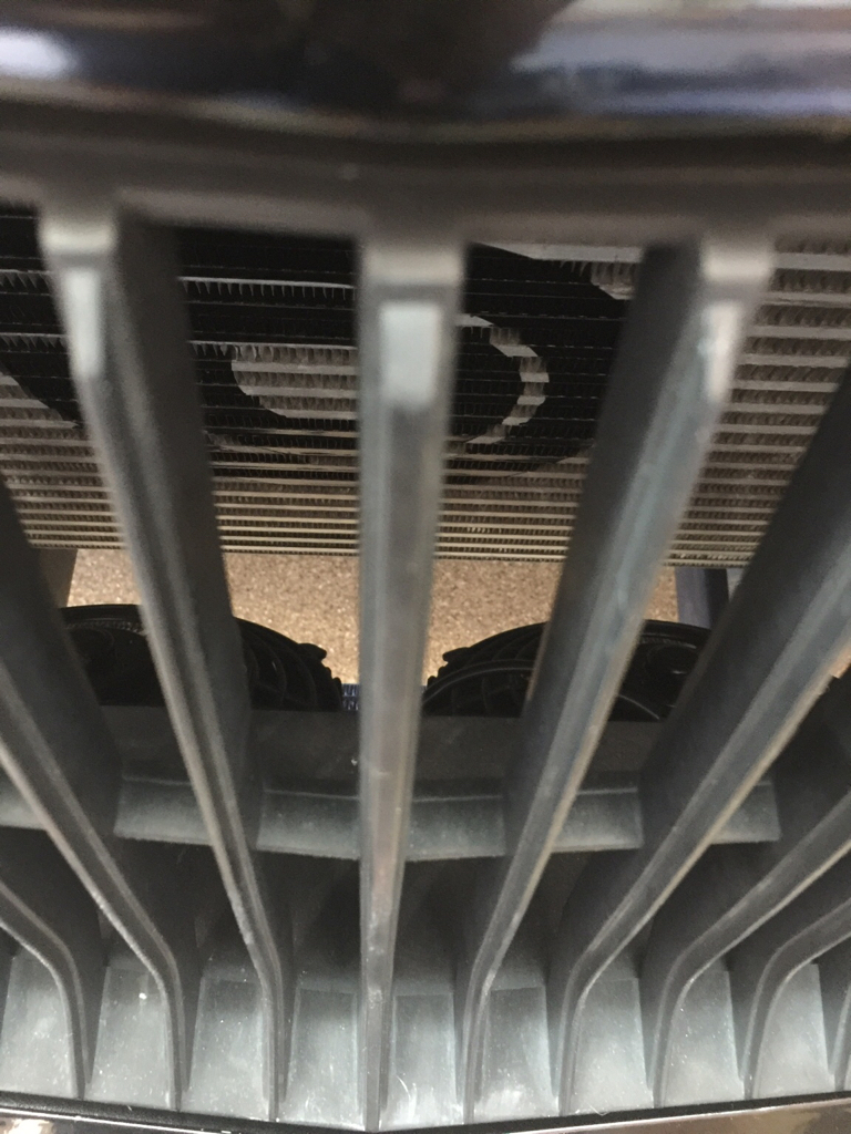

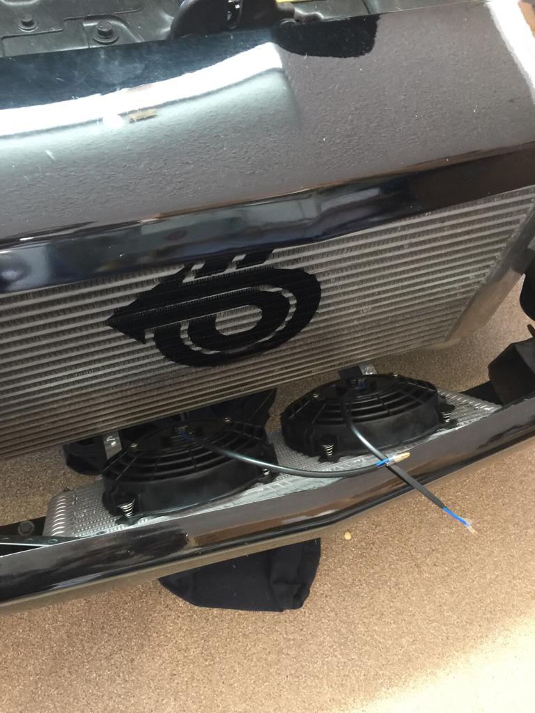

I am using dex6 and still using the radiator first. The fans are set to come on when the trans fluid reaches 165 degrees. I have not raced the car yet but cruising around in Florida the trans temp hasn't gotten to 165 yet with the fans off.
My cooler is a low pressure drop cooler.

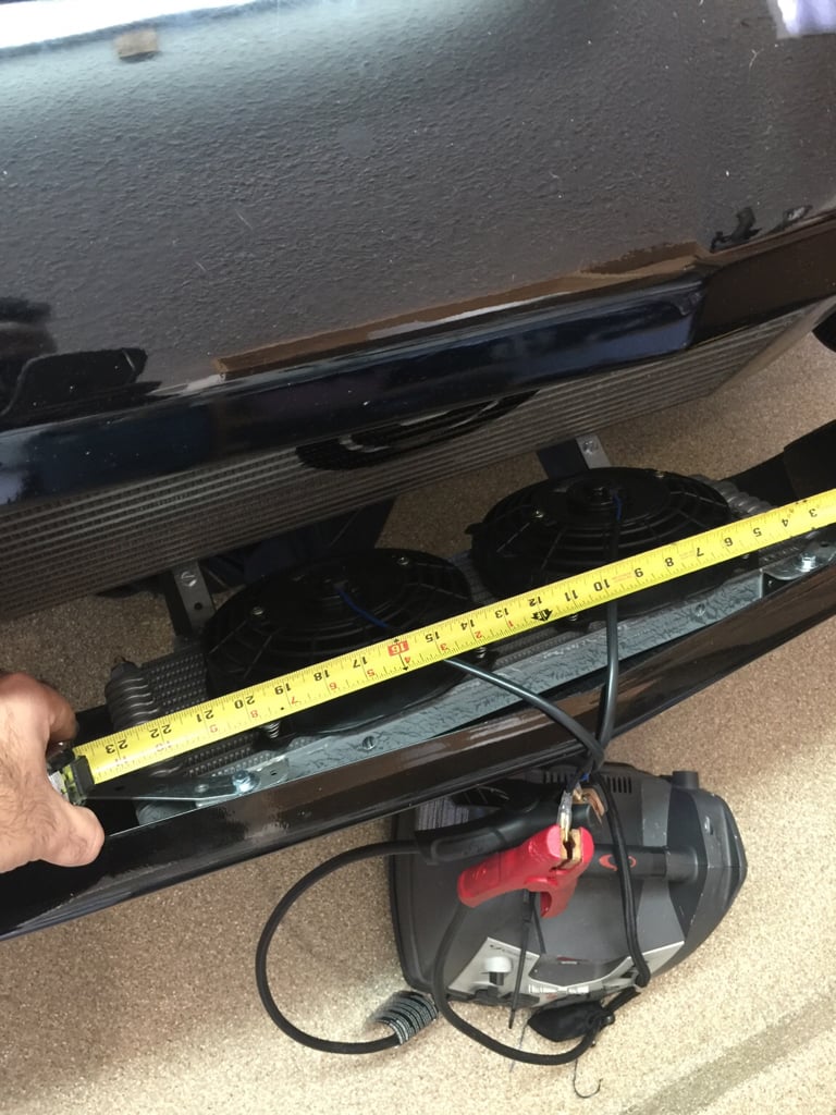

Here's mine before I put the nose back on. It's a B&M. The straps came with the cooler. The smaller one to the driver side is power steering. If I had to do it again, I'd probably go bigger, mount it underneath somewhere, with its own set of fans. I'm not sure this one is big enough for what I'm doing.
Engine is currently out, and I'm going aftermarket ECM when it goes back in, so I'm going to add transmission temp and pressure sensors and start logging it to see.
