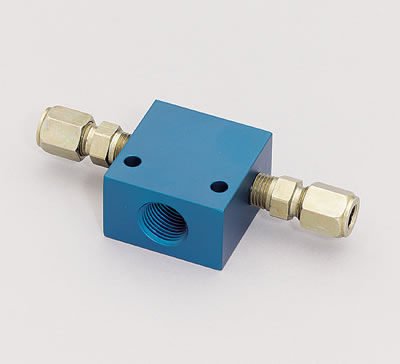

MSD, I just ordered the gauge and sender from Dakota Digital, and I was wondering about the ground, I will prolly use silver solder and put a dab on the tee and stick a wire to it and go from there, thanks.
Ron
That's what I did...you can't see the ground wire in the pic because it's on the other side of the brass tee...I then just put a ring terminal on the end of the wire and attached it to the same spot on the fender where the battery has the smaller black ground wire attached...
