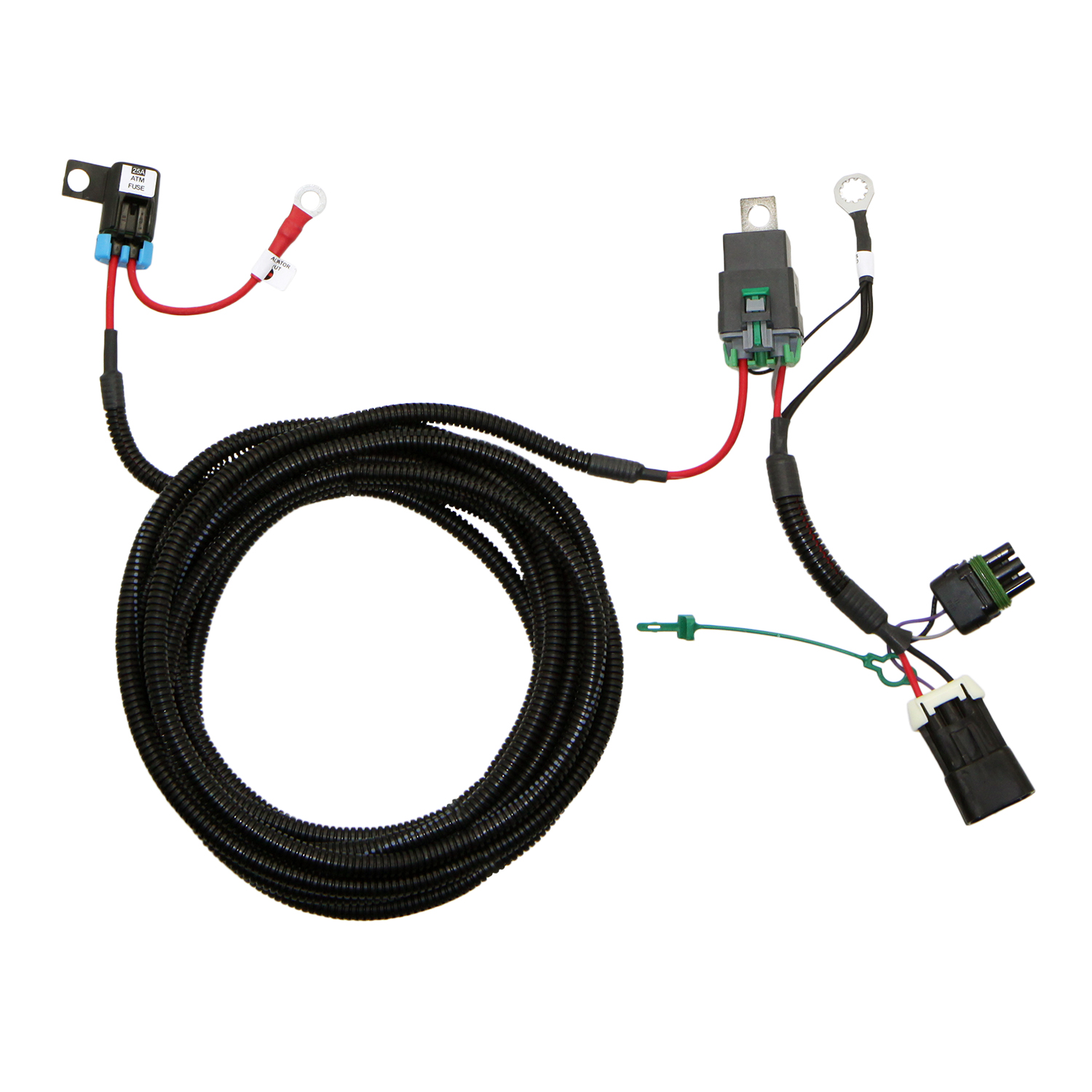

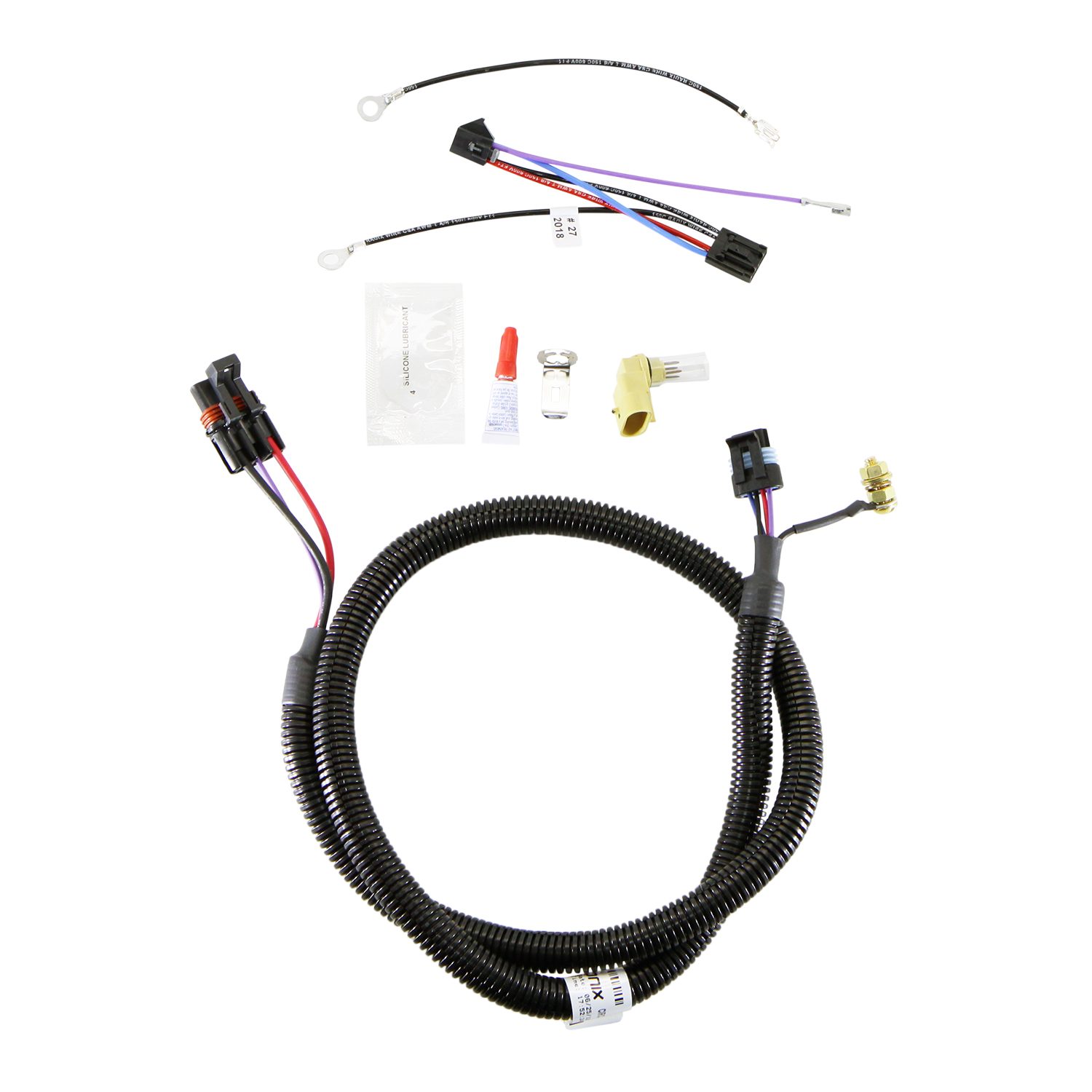

Beef that stuff up with some new wiring. If you need to swap polarity it's no big deal. Just de-pin it and swap.
fpwh-018 has a grounding ring terminal that gets bolted down in back of the car. Make the most of the ground by making yourself a ~16ft long 10 or 12 gauge ground wire from that bolted terminal all the way up to the front of the car where it grounds to the battery.
