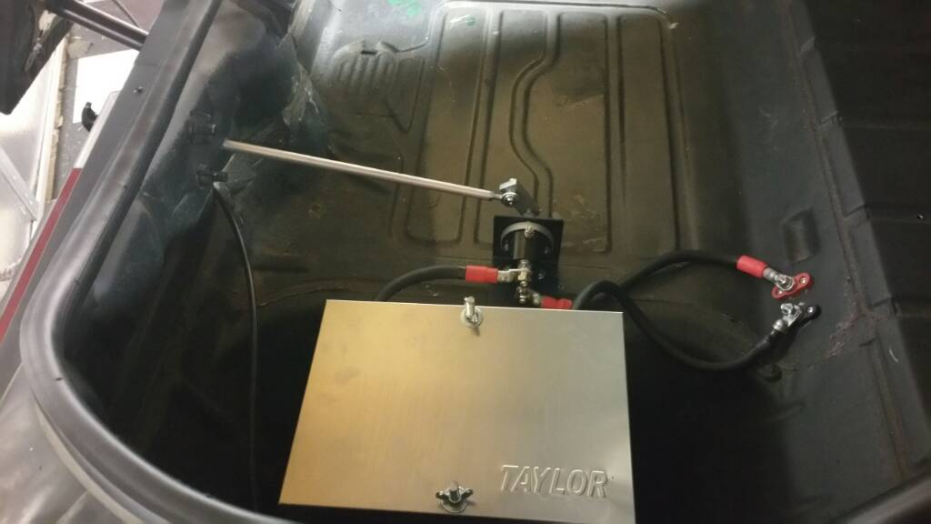

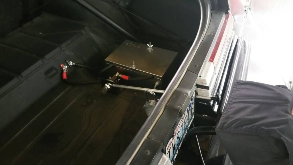

This is the set-up in my race car with 2 batteries which has been great for years as I never have an issue with enough power for an entire day at the track.
One of my street cars has a single battery in the trunk as well.
It is important to run both positive and negative to the front of the car to 2 distribution junction blocks, one positive , one negative.
Do NOT use the frame or body for any power or ground path as we found years ago it will cause issues.

Modified mount to fit profile of spare tire well
Used an 1/8 inch plate across the back
Mounted with 7/16 grade 8 bolts
I decided to go this route pretty easy installation accept welding a flat shelf in the spare tire area
