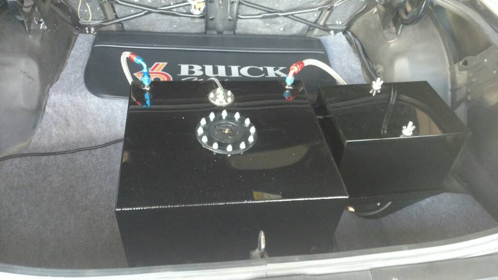

I decided to go this route pretty easy installation accept welding a flat shelf in the spare tire area
I like the clean look also.Here's mine with an Al plate put in place of the spare tire well... I like how it looks without the spare tire well hanging down.
If you go back to pics in my post #21 in this thread, If you look closely, you will notice I also used that same spot for the coolant reservoir. Mine was made of aluminum sheet metal about as large as the the factory charcoal canister, only deeper. I cut out the bottom of the round depression in the plastic inner fender cover. I used a weld on cap and bung assembly and vented it with a few little holes. It holds about a gallon.I'm going to copy this. Because I plan on mounting my over flow where the battery used to be and I can hide my junction boxes underneath the Overflow perfect[emoji106]
Very niceIf you go back to pics in my post #21 in this thread, If you look closely, you will notice I also used that same spot for the coolant reservoir. Mine was made of aluminum sheet metal about as large as the the factory charcoal canister, only deeper. I cut out the bottom of the round depression in the plastic inner fender cover. I used a weld on cap and bung assembly and vented it with a few little holes. It holds about a gallon.
It has a tube inside extending down to within a 1/4 inch of the bottom making it a full recovery reservoir (not just an overflow). I polished it out, but it was too much on the eyes. So I decided to have it powder coated to tone things down a bit.
I even put a drain in the bottom so I could empty it under the car.
