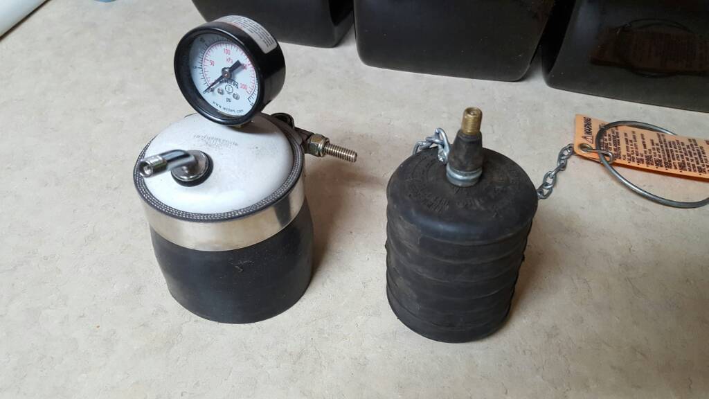

Intake plug test seems pretty self explanatory with a PVC cap. Did you use a 2-3/4" plug into your up pipe to throttle body? How about a type of a cap for the exhaust? Go from the tail pipe?

The plug used for the downpipe, what exactly is that? It does not look like a fabbed piece
When I bought mine they where 15 bucks.
Sent from my SM-G920T using Tapatalk
hell I think I may be able to make one to get the test done sooner. So one test you are leaving the rockers down, the other test you are taking the rockers loose??

The one I made is similar. I used a thumbwheel regulator and guage. You get the idea. You'll only need about 10 lbs of pressure to show the leaks.
I like to use a shop vac with the hose on the exhaust side of the vacuum. Clamp the hose to the maf pipe and turn on the vacuum. Do the same with on the exhaust. If you have dual's just cap the other pipe. The vacuum moves enough air you do not have to mess around with the rockers. Use soapy water in a spray bottle on suspected areas.

for $10$ I made my own intake pressure tester and bought a test plug ball on ebay for 10$. So I have $20 in a complete test setup for this weekend. Last weekend was able to place the car on the lift and listen for exhaust leaks, and found none. Actually we did not find anything with trying to load the exhaust so I am going to go this route. Couldn't get the rear brakes to hold boost either. Adjusted the rear brakes....nadda.. My Hydroboost is leaking and is tired, so it will be replaced with a new hydratech unit. Keep plugging away till I find something.
