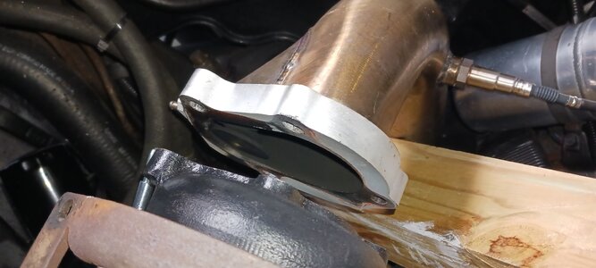

check the downpipe puck arm tension , not usually an rjc pipe issue but have seen bent puck bracket inside pipe that caused puck to rattle

Thanks Pace. Don't think its the puck arm I just had the RJC down pipe off about a month ago. Also great advise.
