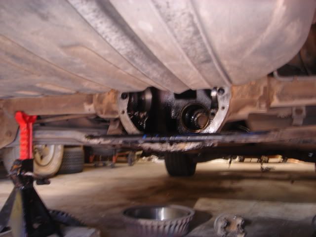

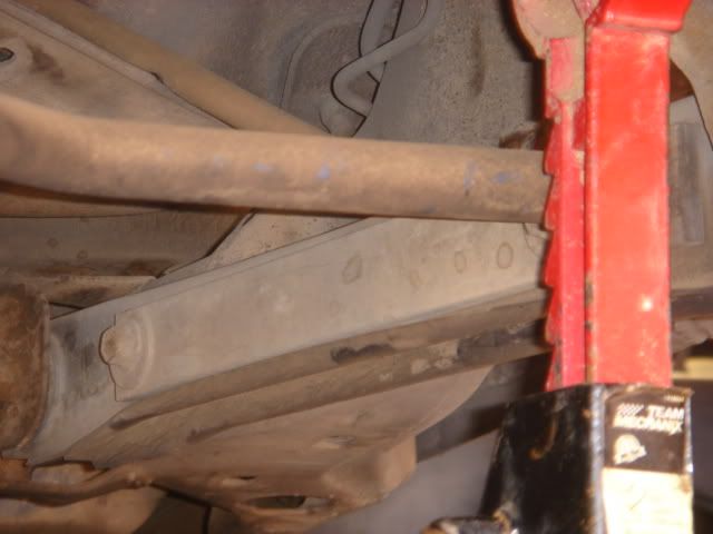

wow! thats wierd, when i get home ill attach some pics of the sway bar to this post, maybe someone can tell me what kind of sway bar it is, i was told it was an atr bar. its definetly not a stock one though, the thing is thick, also the rear most hole in the stock lca bolts up to it but the second mounting bolt for the bar to the lca is at the complete other end of the lca, thats why i can use the umi lcas.
thx for the info
buickbert
The UMI LCA's should have the exact same sway mounting locations as any other LCA's. I would have to go out and look at mine to see if its possible but I wonder if maybe the LCA's could be turned around backwards which would make the sway bar mounting holes offset?
Steve, they can be mounted backwards.
I know!
If there is a 50/50 chance on something, I will always do it wrong.
here are some pics of my sway bar, in the pic showing where it mounts you can see a flat piece of steel that bolts to the stock lca on the stock rear mount and at the other end of the lca like someone drilled out a hole, the sway bar is welded to that piece of steel. if anyone has any info on this bar please get back to me, it is because of these mounting points that the tubular umi lca wont work for me.
