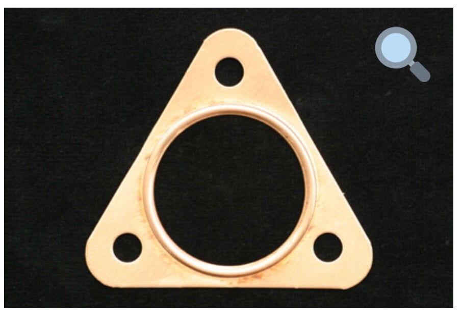

Installing my turbo with this new copper gasket that Bison sent. Is there a certain way this raised
lip on the gasket goes. Pretty simple ? I know just wanted to ensure that I got it right. It actually fits both ways.

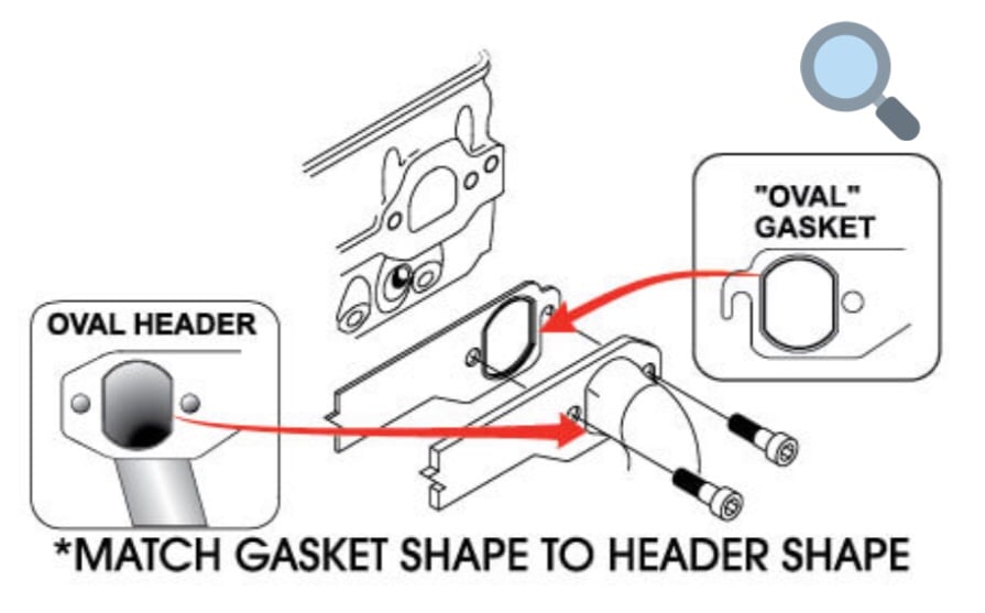

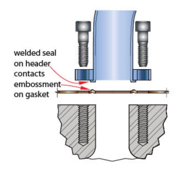

According to the SCE website for part number 4172:
Kind of confusing because they show a header diagram for a turbo gasket. haha
I can see how the orientation may matter for a header gasket based on their diagram.
In your situation with the header and turbo exhaust housing being machined surfaces I really don’t think it matters.
If you look at their diagram and philosophy you could infer two things:
1. Based on the gas flow the ridge should go with the flow.
2. Based on clamping orientation ridge should be towards header.
Bottom line just put it in. Haha
Torque it and then retorque it after a few heat cycles as the copper is soft and will deform/match the mating surfaces.
And make sure to put a little bit of anti seize on the threads. Copper anti seize if possible.
Good luck buddy
