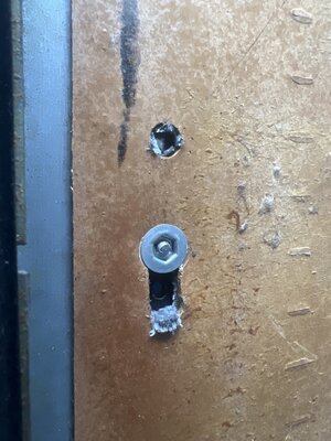

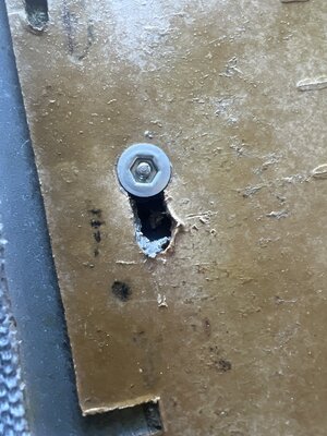

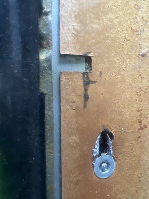

Finally I’m to the point of trying to install my inner upper door panels. Sometime ago I purchased some new black door handle straps, however the back of the area that they secure to on each side is torn out, anyone have any creative ways to secure before I take them to an upholstery shop and see what they can do the part that is torn is the part under the escutcheon that would secure the handle to the door

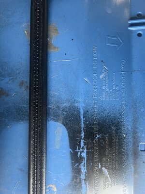

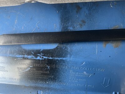

Also, I do not remember, but do the handles have the smooth side out or the ribbed side

I used 1/4-20 threadserts in the door.
Drill hole, using threadsert rivet tool install threadsert, & install 1/4-20 bolt.. The strap assembly will be WAY stronger & you can actually pull the door closed using the strap & not having to worry about pulling out the strap screws.
Ribbed side out smooth side towards door panel. They should only go one way. At least mine did.
Did you have to relocate the straps or are they in the same spot as before?
i do the same but with m6 serts so i can use oe flange bolts with 10mm head
Nope. Same holes can be used. I believe the threadsert is a bit bigger hole than the O.E. screws.

another quick fix for loose handle straps that works well without having to pull the door panel is bend the ends of a cotter pin so it looks like a T , spread it open a little and push into hole then send the old screw back in
works like a plastic insert in tile

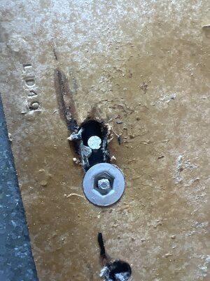

These are all great ideas. Especially the bigger screw one! However the back of the door panel itself is damaged. Don’t won’t take a screw or a nut I almost need something like a washer to shim up the back somehow. I like the cotter pin idea but unsure how long that would last
Shouldn’t matter. You’d be through bolting into the door through the panel. Nothing to be held on from backside.
The nuts on the backside of the panel hold on the square portions of the strap assembly.
