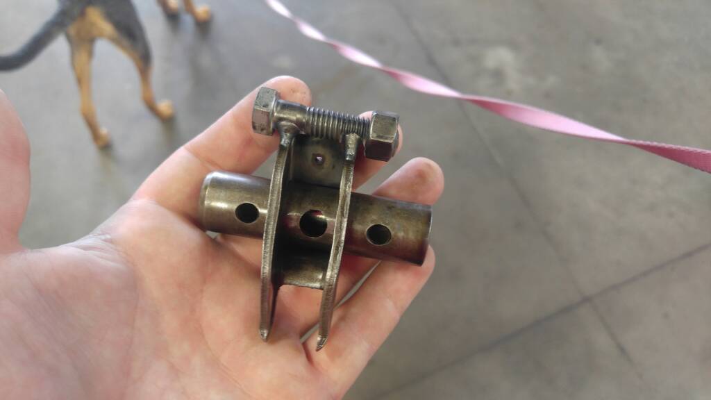

Call cottons. He makes a tool which is made from an old rocker and shaft and is perfect for the job. Just finished changing springs in my car. With a 3 foot extension 1/2" on one side 3/8" on the other with a 14mm swivel socket, 1/2" ratchet and 2 people the job is a breeze. Person 1 can compress springs from the front of the car and person 2 swaps springs, retainers, locks, take measurements, etc
