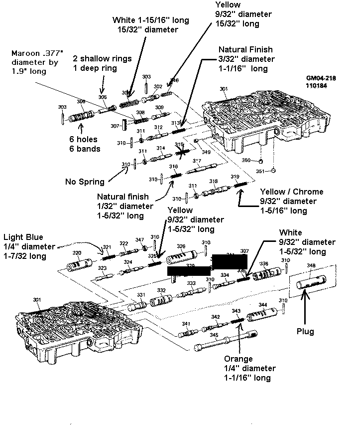

http://www.gnttype.org/techarea/images/valvebody.gif
WHile i'm no guru either, I would have to think something changed in the 334, 335, 336 pieces as I believe according to the gnttype.org pic that is what controls the 1-2 shift. This is of course the brf vb so the kc might be a little different. Are you sure you put the sleeve and plunger back as they came out? Might try to find another KC vb and swap it in. Or look at the stuff/springs in the replacement kc and see if they are different.
