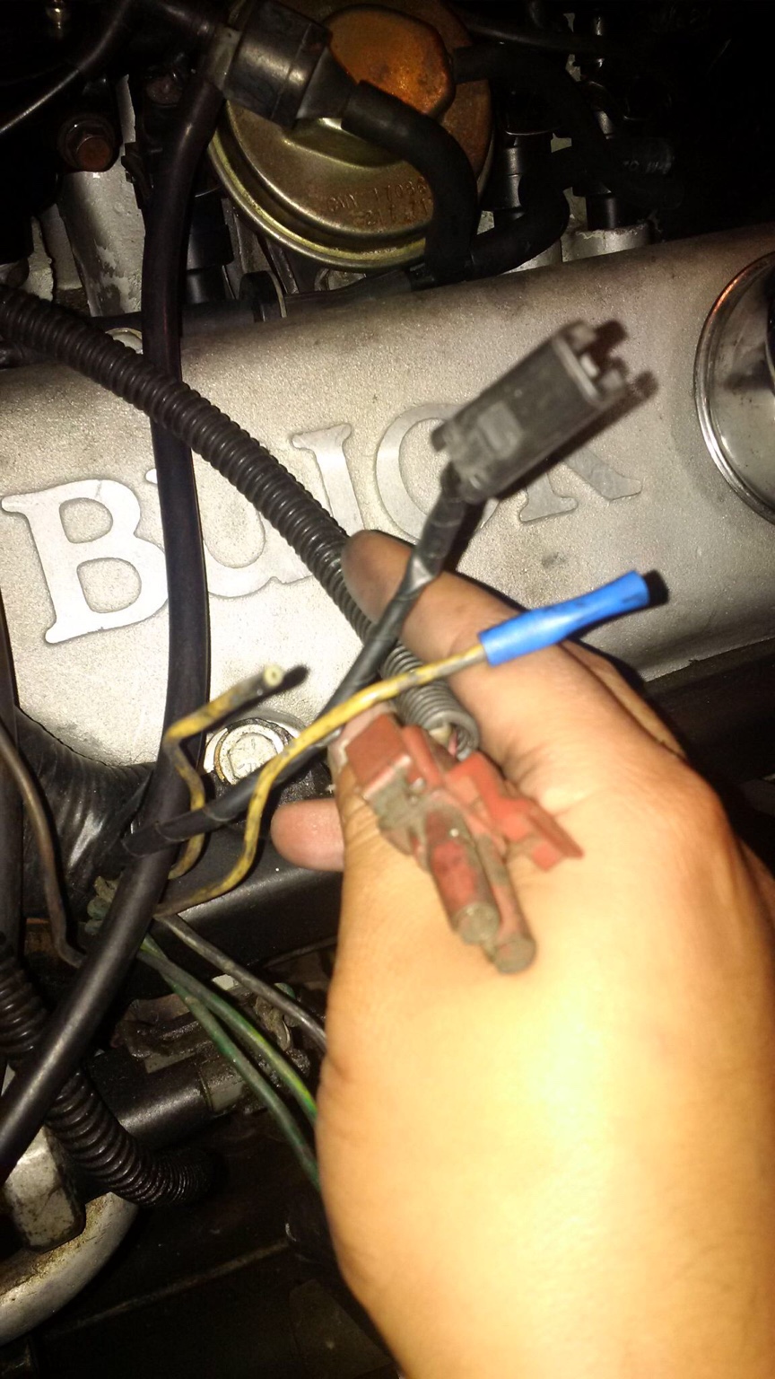

The pic below is driver side valve cover area... What is the single yellow (butt spliced connector---was already like that when I bought the car years ago) and black plug for?
Red plug is/was for the vapor canister solenoid. I think the black is a test plug for fuel pump? but not sure so get a confirmation on that.
Black connector (notched) looks like it's for the "HOT" dash lamp, switch on front of intake.
Yellow wire could be the coolant temp wire. That's about the only yellow wire in the harness at that point.
