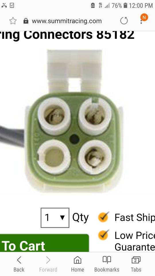

The plug for lock up is different from 85 to 87.an I belive the servo is different.
Yes,looks the same.now look at your plug there are key ways cut in to it that allow it to plug in oneway.
