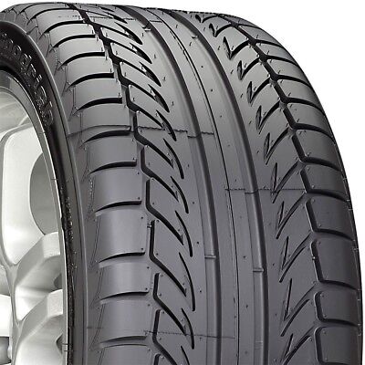

There are a few choices in 245/50, but BFG G-force Sport Comps are the only street tire in 255/50. Otherwise Toyo makes road race/drag radials, Mickey Thompson has the ET Street SS drag radial, and Hoosier has a drag radial and road race tire.

That's what I have on mine BFG's. I agree, not many options in that size.
