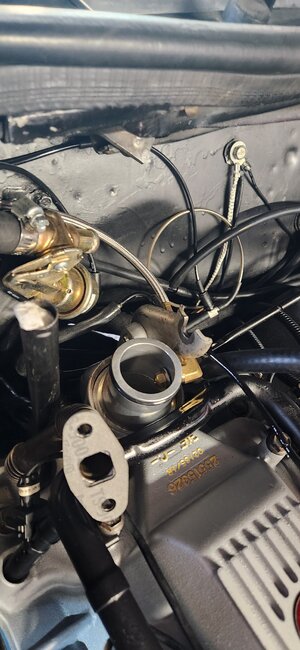

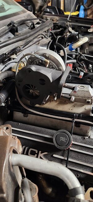

I received mine in January and I'm very happy with the upgrade. Tip # 1 - Don't forget to apply some liquid teflon goop a few threads up from the base thread of the oil feed fitting. Tip #2 - If you're thinking of upgrading to an Alky system, now would be a good time to add a M15 nozzle to your turbo-to-intake adapter.

Nice! Looks like you have the same mods I'm doing only I'm going to run E85. Were you able to sneak the nozzle in around the driver side mounting bracket? Also are you running the nozzle straight in or at a 90- seems like a narrow space for the alky to atomize
Yes, I was able to sneak right around to the driver side, just past the turbo to manifold bracket.

Where did you get that oil SS braided line from?

I just installed my Alky Kit on my 85 and was told by Julio not to use the washer that presses between the nozzle and the neck between the turbo and intake. Instead leave it off and use some loctite. And making sure to use the correct thread tap so the fitting screws in.

I'm not picturing just where you tapped for the nozzle. There is no room between the turbo and intake manifold. I'm missing something here. A pic would help.
