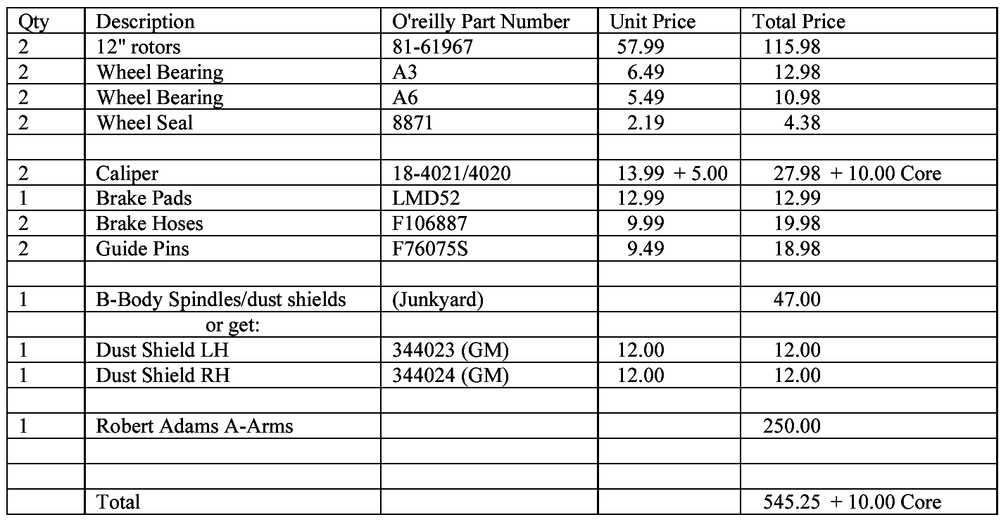

Here is a parts list:
Prices are from a few years ago, from O'reilly auto parts.
The Arms robert adams was selling are from UB machine and are similar to those sold by G-body parts for Stock spindles.
If I was contemplating this swap today, I would probably go with the ZQ8 or LS1 brake swaps to get better calipers and less bump steer.
