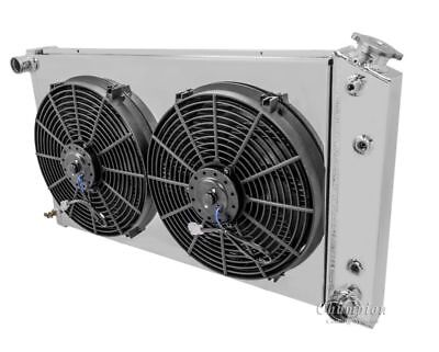

Hmm, well, it’s a Champion 3 Row Downflow Aluminum Radiator (not sure what the difference is between down and crossflow), but it is rated to 600 HP, oh and did I mention that it has a Lifetime Warranty (and Free Shipping)? Anyway, here are the specs:
Buick Regal Grand National Aluminum Radiator & 2-12" Fans Champion 3 Row CC683
Price: $305.97
Item specifics
Outlet Diameter: 1 5/8in.
Inlet Diameter: 1 3/8in.
Manufacturer Part Number: CC683 CH
Core Height: 16 7/8in.
Overall Height: 18 3/8in.
Core Length: 26 1/4in.
Tank to Tank: 31 1/4in.
Overall Length (width): 32 1/8in.
Row Count: 3 Rows
Core Thickness: 2 1/4in.
¾-16 UNF / ¼-18 NPT
Brand: Champion Cooling
Style: Downflow
Fitment Type: Performance/Custom Interchange Part Number: DPI 683,434097,CU683,683
Material: Aluminum
Warranty: Lifetime Champion 3 Row Radiator, Electric Cooling Fans
1982- 1987 Buick Grand National All Aluminum Radiator & Dual 12" Electric Cooling Fans,
This Champion 3 Row Buick Regal Radiator Package includes Electric Cooling Fans and It is rated to cool up to 600 HP, the radiator comes with a Lifetime Warranty. This Buick Regal Replacement Radiator is setup to fit the Buick Grand National, The 1982 Regal Sport and the 1983 Buick Regal T-Type.
Buy it now! Free Shipping !

has anyone seen this before or put one in service ???
Think that "Downflow" is a typo. Looks like a crossflow.
I bought a Champion radiator for a previous G-body. It was nice.
How do you tell the difference?
Also, found an aluminum shroud (for two 12” inch fans) that fits the above for $109 with free shipping. So, that puts the whole system at $418.57 for the aluminum Radiator, Aluminum Shroud and Two 12” Inch Fans, all in. Which is insane.
Tanks are on the side vs. top to bottom. Pretty much require the tanks on the side for the 2 oil coolers.
Champion used to be 100% made in the USA. Don't know if they still are.
PS. Good time to replace the oil cooler lines if needed. Check out Highway Stars.
I don't think an 1/8 of an inch would be a deal breaker, what'd you find sounds nice
1/8 larger probably not.
1/8 smaller . . Not sure if it will seal.
I wouldn't roll the dice.
Someone needs to try this and report back. Lol
I have already installed one of these radiators in a 86' GN. There are fitment issues but it is a nice piece. It's not a plug and play. Some modifications are needed. It does work well though.

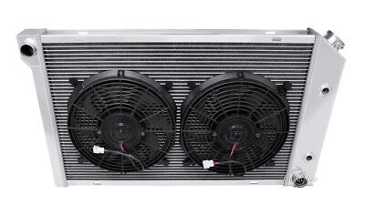

I ended up going with the two core Cross Flow with 1” inch tubes. Which was only $368 all in for 2 Row 1’ Tubes Aluminum Radiator & Shroud and Dual 12” Fans.
Item specifics
Radiator, Fan(s) & Shroud Brand: American Eagle Radiators
Fitment Type: Performance/Custom Manufacturer Part Number:
AE162-40 AS
Material: Aluminum Interchange Part Number: CC162,EC162,MC162,162,2511,24-80866,PRO162A,433162,8162
Fan Size: 12 inch Surface Finish: Polished Aluminum
eBay item number:122919991619
