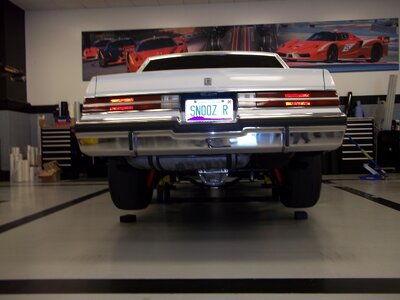

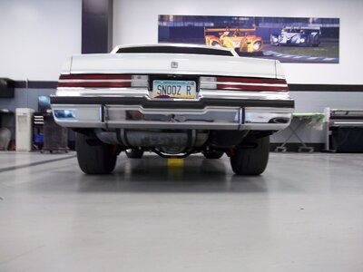

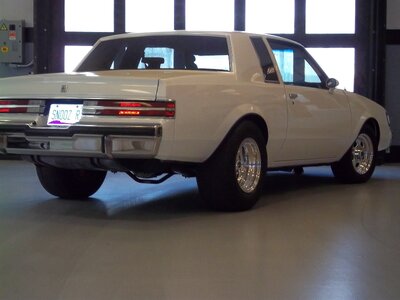

Searching through old threads and photos on my PC I came across a pic I had saved. I believe this is toomanymodz car which was originally posted here. 15x9 rear with 4.5" backspacing. 295/55 tires. One of my favorites.
295/55/15 MT DR's on 10" rims, 4.5 backspace.

TurboTGuy, very nice and thanks for adding size details with pics. I assume you're also within a .25-.5 inch of touching the frame rail if no frame notch?
All I can say is very, very close. Never measured. Closer on the right side than left.
