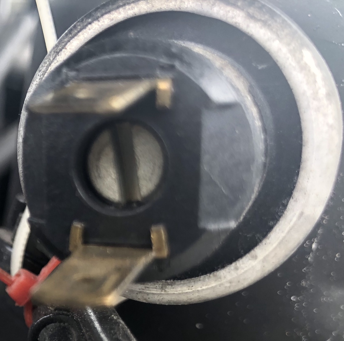

The switch should work fine. The stock ones are adjustable and I would think the new ones would be adjustable also but you should be fine at 21 psi.
Stock adjustable screw
Part stores used to sell replacement134 pre-set switches for GM cars that were set a couple of psi. lower than the factory switch, which as mentioned and shown above is adjustable.
Replaced the swich and all seems good so far. I ended up with an R12 switch with a turn off of 24PSI.
I did adjust the screw 1/4 turn CCW to lower the pressure.
