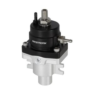

Suggest you replace with a Kirban’s Aluminum FPR or Racetronix FPR.
Never had any such issues with either of these
