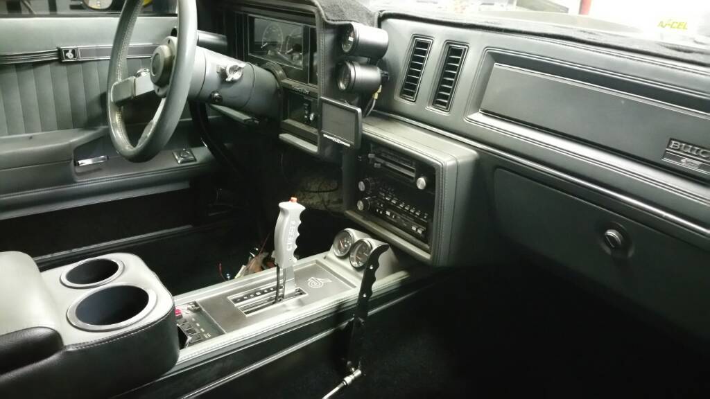

B&m stealth pro ratchet, im not the first to do this but im very happy with how it came out. Just had to cut off the mounting pads for the stock shifter and bolt it straight to the trans tunnel then wire up a park/neutral and reverse switches.
