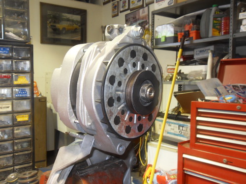

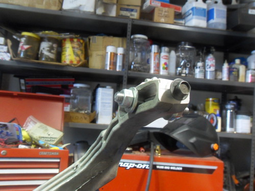

I have this bracket that i modified for my hotair a long time ago to address the need for more amps and also the need to stop a belt slipping issue at wide open throttle.
The alternator in the pic is off of a 1996 caprice cop car and is rated at 140 amps.
I would probably $40 shipped for this bracket +3% paypal.
