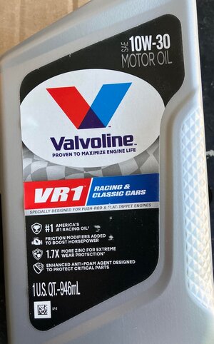

I’ve read conflicting/confusing info on this. Is Valvoline VR1 oil detergent? It says for racing and classic cars on the label. Thanks.
Oil isn't a detergent. It's oil. The additive package might have a detergent in it, but oil is not a detergent.
Valvoline VR-1 is a good Racing Oil but contains no detergents.
I used to use it, but upon learning this I switched to a high Xinc / ZDDP engine oil, that does contain detergents, since my car is a street driven vehicle .
I now run Joe Gibbs “Driven” motor oil that satisfies both criteria.

Yes, that is correct . So more frequent oil changes are definitely needed with VR-1.

This is what I have (attached). I asked my question because the label says “RACING & CLASSIC CARS”. Lots of classics cars never race, so wondered if there were any detergents in it and whether or not you should change it more often. Thanks.
