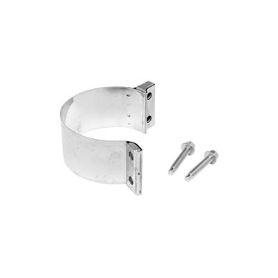

Just get yourself the correct length of 2.5" pipe and if you don't want to go get it welded order two clamps to mate it with the pipes at each end and you're done.

Exhaust Tubing, Straight, 2 1/2 in. Diameter, 4 ft. Length
