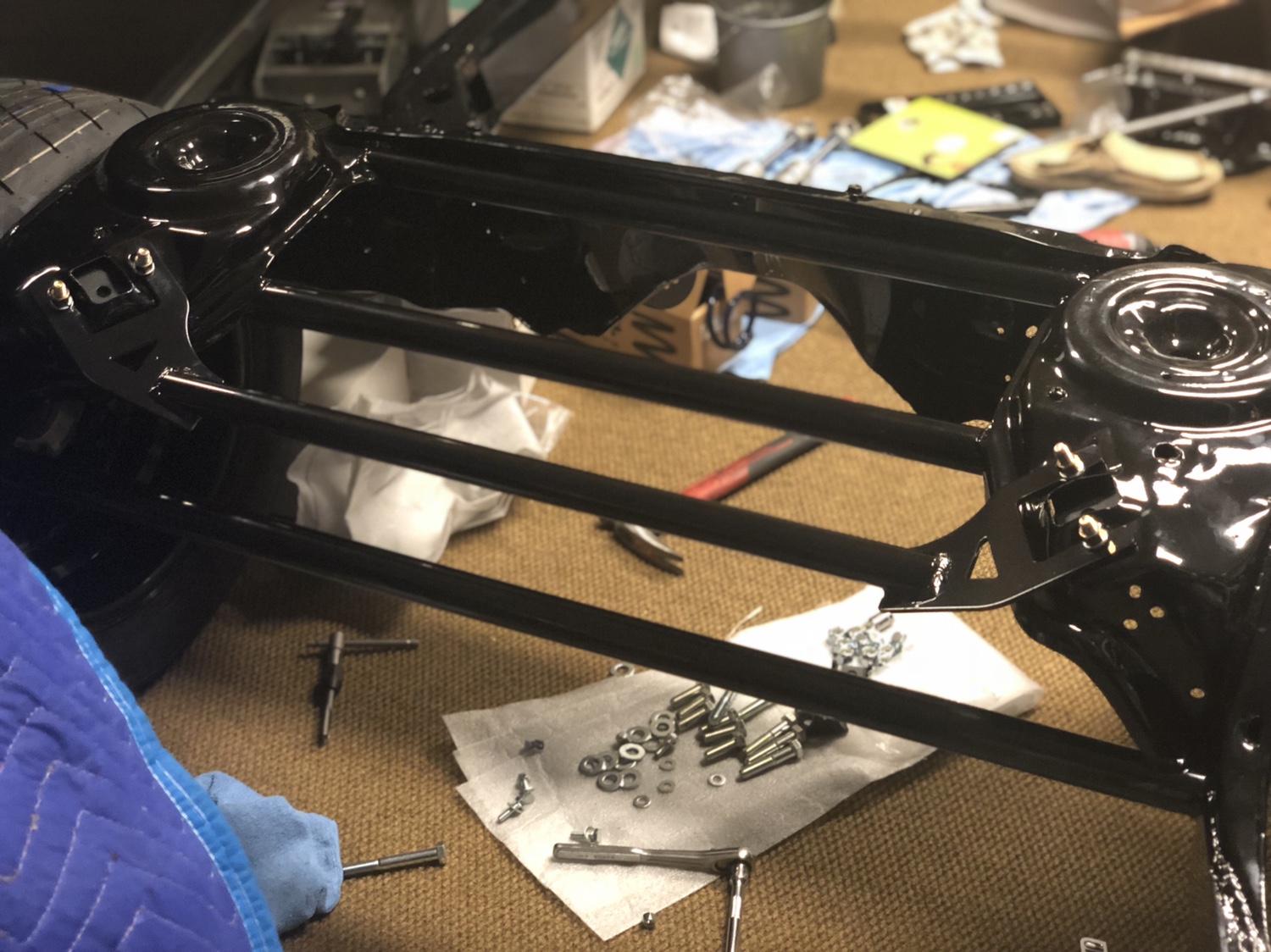

Installed mine today, looks good. Not sure if it will make a difference since I have plenty of bracing as it is.
Wow...that's one pretty looking frame you got there. It looks like you're doing a frame off restoration. Very nice!!
