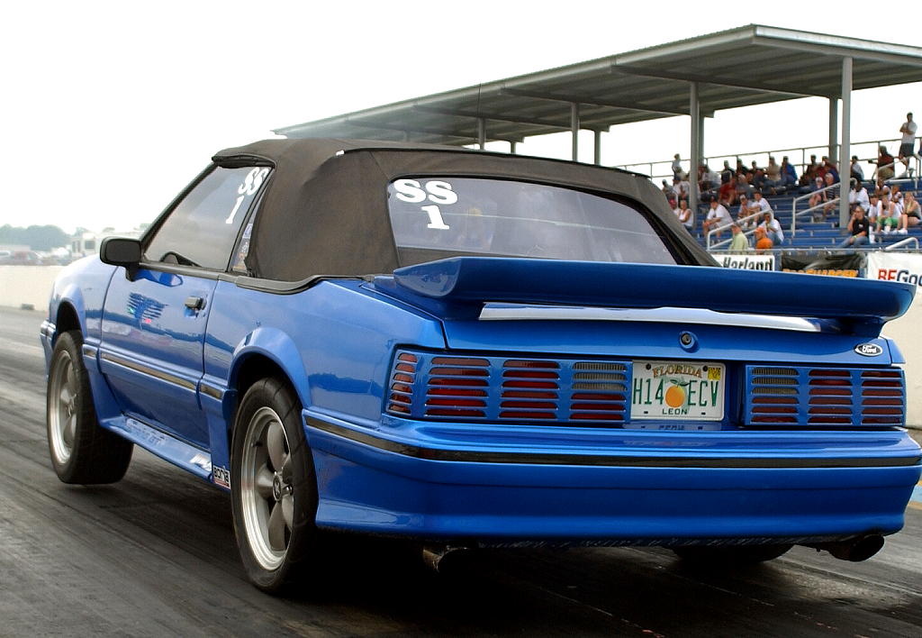

Really? Check some of the mustangs out....I've heard n think there's you tube vids of 8 sec passes on 17 s......check out the new cameros on 20s....it def can be done. Need the suspension working correctly it helps....
M&H 275 50 17 works well. I tried a 275 40 17 Nitto NT01 and I can't get it to launch consistently if at all, but on the street the NT01 is perfect and handles awesome.
Mustangs:
