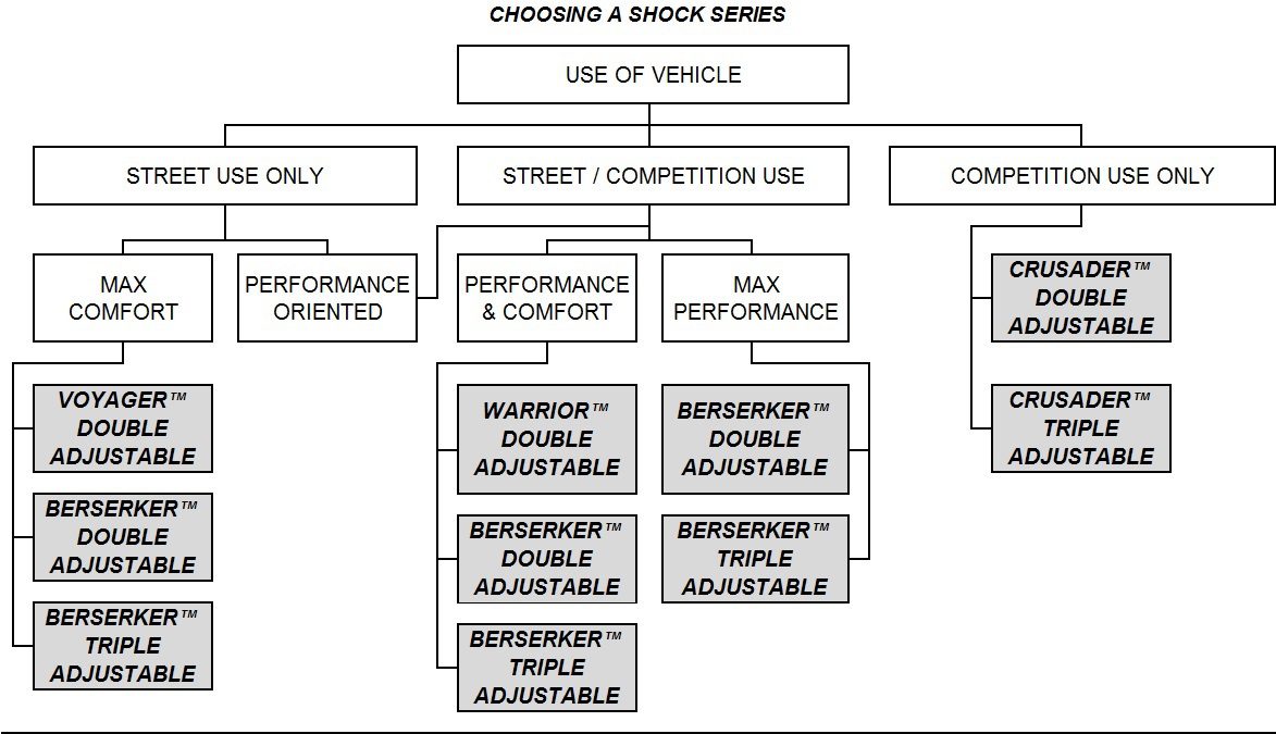

Tech said to get Viking double adjustable front coilovers
Call them. There are some part number choices depending on the application.
Here's a link describing the various choices.

Thanks for all the tips, I'm learning and got some info fresh from Viking...
My front end currently weighs 1908lbs.
Goal is street driving, more straight vs cornering and hooking.
Viking double adjustable coil overs
Model = Berzerker $820 (with spanner wrench) $770 through retailers.
450lb Spring
Standard to 2" drop range
Part Number = A424hb-450r
2-3" drop range
Part Number = A434hb-450r
7995-102 spanner kit #
The above is a tweaked valve for the cars intended usage, I'll need to align the car and then test out the knob settings with some street time but it's clearly better than my stock arms, 2" drop springs and normal shocks.
