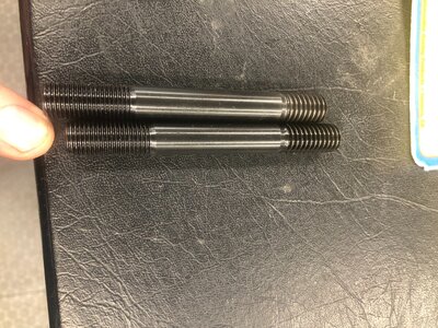

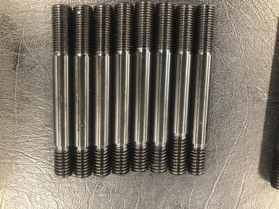

Getting ready to put my refreshed Champion irons on my new short block and decided to go head studs this time around instead of the ARP head bolts. Noticed something weird about thread lengths on the block side. The middle size and longest size have the same thread length. The shortest studs have one with the same length as the other sizes EXCEPT all the the rest of them have shorter thread length. See the pics, were these made on a Friday? Shouldn't all the studs have the same thread engagement in the block?

forget sealer did you look at the pics of the studs , the one is wrong maybe for a hotair block, send them back
Just an update on this, ended up with a 2nd set being the same way! Sooo, I then ordered a stud kit with 6 point nuts vs the 12 point I ordered for the other two sets and lo and behold the studs were correct. I checked for the middle size studs that people had issues with once the heads were dropped on and the thread was well below the washer surface of the head. Guess they corrected that problem?
I went through that with mine years ago. I had to add extra washers on the ones that were too long. Maybe they have finally corrected that after all these years.
I installed ARP’s stud kit (6 point) & needed extra washers to fix, but this was 2yrs ago , so hopefully they have made the adjustments to fix the stud lengths
