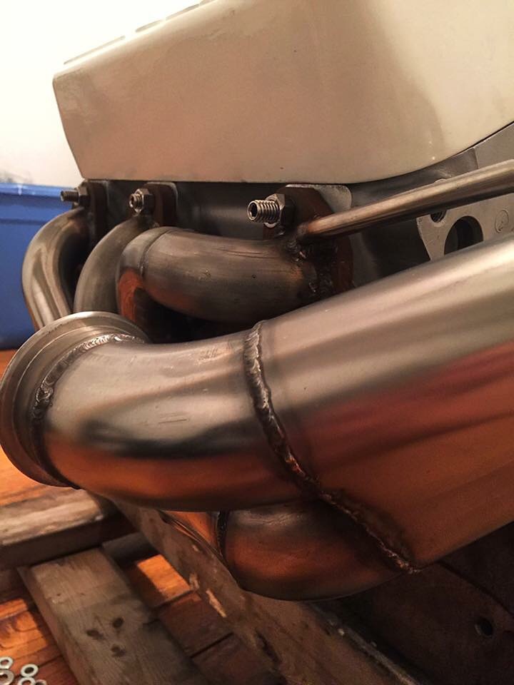

Replaced my stock header bolts with SS studs from McMaster Carr. I would have to look at my build sheet to get the part numbers and/or other info.
Just my opinion, but the stock bolts are excellent as the captured washer keeps them from loosening.
On alum heads I prefer studs, actually long set screws with an allan head and flanged nuts.
The twisting and pulling force on alum threads with bolts can easily ruin the threads.

Stainless studs and nuts?
I got my stainless sets from Earl Brown. Header bolts and think i bought a stainless set for the water pump or front cover, they all worked great and looked nice. Plus the price was good and if i remember they came with pictured instuctions but it has been a while.

I do use 2 studs on each header though,it makes it easier to install them.
My brother bought his off Ebay from Earl Brown. My brother is a picky and meticulous sob. He was very happy with Earl's kit. Looks easier to retorque also vs the stock stuff.
