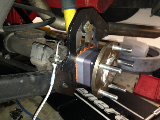

Strange C-Clip eliminators with the tapered bearing option. Hoping this cuts down on pad knockback and lets me get more than a few events out of a set of rear bearings:
thfxGqA9IM-QTUpIfkXrO50gGbk7MGDqgz_-ZRp7y25x_NJ47qASFydaSiKjkoBlwo1rEcgCcwTG1MDYbK80QwcjOFG2Ks1O_tjC6GcLLs-t1C_BUQ3M3VgIwtqAVeQUMXA7FGxNtyw

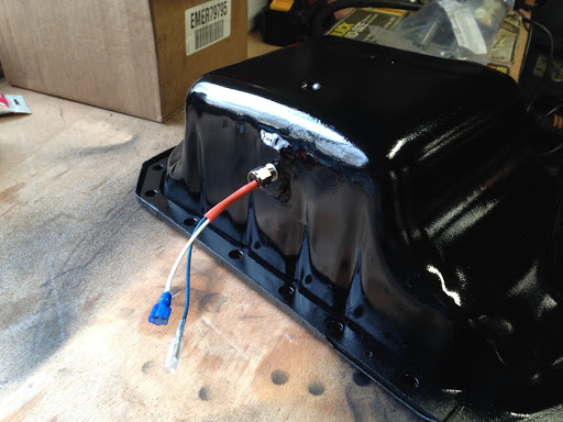

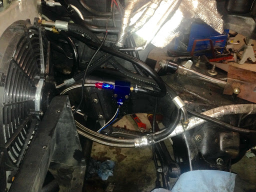

Transmission Temp, oil temp, fuel pressure, and transmission pressure sensors plumbed and wired in:
ybwKRVWtz37NmweCvX8eSyXT_DOChMvTvE0RMtK-IptXawunx8aP9CemqwmmAgS6bh3iGNapk0SU8UCQL0tfopenFSsBFrNiea2gMKjabM454C9JWWbRm2Gr5D98bCuxiTsdmyYjSJE
jj43OShW8v4lSLmP3KlvcWzCkcvzU4HVgLjXVajSy0naZwnuopnR86OMAwKYVNS-GlxZGx7NlNkVPh_4mcU_VvPmI7phh93rRr7pT9o1ph_78dNLsAusbh852Yb-tzdf9Hrv31zej0c

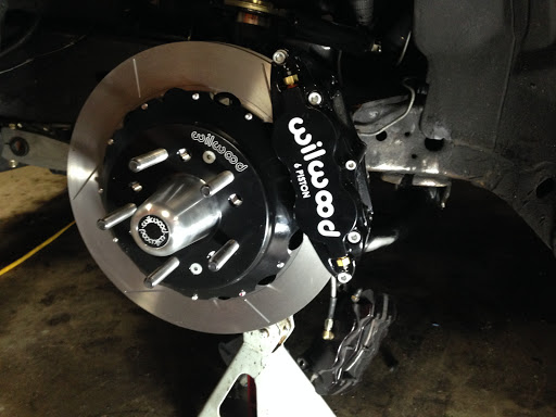

To give me enough heat dissipating ability to get through more than one event on a set of rotors, new front brakes. Wilwood Superlite 6R with the 13" floating hat directional vane rotors and Hawk HP+ pads:
jqV54EM2FjXRdB0qY__ZKpBFifmrXXyccrrlJ_Izir0BH4RxEP3eA9aqLIBzaOZW-DiK9nTzFGkpJhg4ttVeWPdPGkNPobTwq_MtXVlAbrs0A_vmKvHGOIyKa-MaDuC0cjwZZCSsyNU

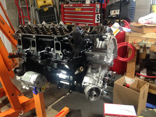

And the pièce de résistance, a 4.1L stroker with a 4340 forged steel crank, Molnar rods, Carillo forged slugs, a comp roller, and fully ported iron heads and intake, with all the trimmings:
QaAxTffE8j7rTxf8YyJpWAWFr2Vo0aOARPC7zJ_tpPl-Hv67xB8xw8BBcNTnG7wWOLR7CGkZFBAJsLIZT_m7Gh06H-ftyG-WkH511pYUEUKOwg5JJ5xI_37M2-PZHgIPeh0X_TTzMwM
mny0IvtWRzVvrzq4BYRncfq_wg6GED_EzpH1Ht24dY_SyT_KT-SDGwZRA1qJ4JcsIuyJcIC0FWJWL7OAx9EOtvqeA3kZEiDoz1iedPOT07gc3CUeDkah8-2lv8Od1F30hb0nJwvOgaM
