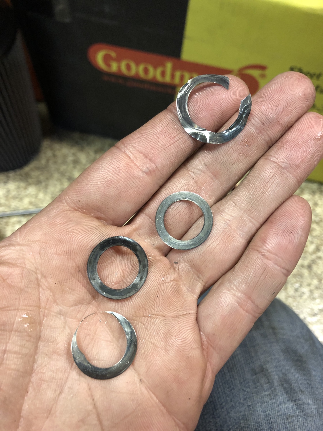

You can put these moroso shims anywhere you want. I put them on the bottom against the original shim and set the (vertical play) to .010. This is how I read the original post.
I see what your using now. My mistake
Not a big fan of shims.
IMO - get new washers and grind thickness to size.
