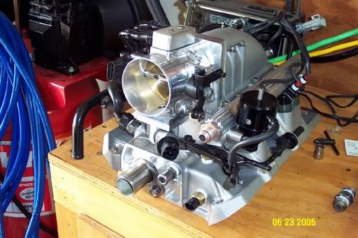

More confusing/confusion! The picture that jjkv posted, of the new intake, had a new plenum, too. But the original question concerned a Champion intake with a "stock TB plenum"- Still think Jason is the man to answer this, but some clafication of the question would help the rest of us.
New Champion Intake
The one that is pictured is the "New Champion Intake" . New design. Power Plate not available yet.
Champion also sells the "stock" intake that has been CNCed and will accept different plenums (stock, PTE, Accufab, etc.). Power Plate is available for the PTE, Accufab, stock.
John
John

New Champion intake + precision or stock or any = not yet available

The plates are designed for the STOCK INTAKE wether its port by me, champion, billy bob, paint blue, green, purple, has my name in ink on it, or been to the moon and back. If it is the NEW INTAKE MADE BY CHAMPION a plate is not yet available no matter what dog house you have.

The Champion intake accepts the BGC plenum. With this line of thought, could you use the BGC power plate on the new Champion intake with a BGC upper?

Using the plate on this intake would be better than nothing but if i remember right when I glanced at yours at this years nationals there was a shelf in the back of the lower intake that would affect things slightly. I need to get one of those intakes and see what We can do with it. I hope there is not much to change and a simple plate like the stock plates will work. This way it is a very cost effective way to achieve even flow.
