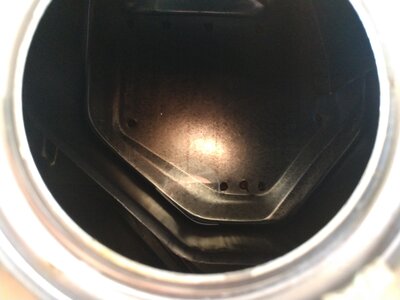

I bought one off of Ebay. I expected one to show up with the silver terne plating. The one I received showed up painted and was bare metal inside. I kept it and was going to use it until the baffle issue came up. This one had the short "pie plate" welded to the bottom. These are the pictures of it and I am convinced that it is an off shore Asian clone. Note the stamped numbers are the same as the Spectra brand.
Last year I purchased a baffled Spectra tank part# GM307C for my 78 Malibu. I bought it with the idea that I would some day convert to EFI.
Note the extensive baffling inside. It is very tall and completely surrounds the pump.

I cut up my original tank before I disposed of it. I saved the original plastic baffle. Funny that it has a GM part number on it. Maybe someday I will get a non baffled tank and cut it open and install this and Tig weld if shut.

The Spectra is the one that is made in Canada. If you look at my 2nd post in this thread you will see the extensive baffling.
All of the tanks have baffling/reinforcements along the rear of the tank. Both of the replacements had it and the factory one had it as well.
But the plastic baffle was the only crucial baffle in the factory tank.

Looks like the new one's baffling is similar to the plastic stock one so I'm sure it's way better than the first one.
