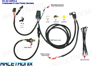

Crankcase E-Vac Pump Harness

A link has been added for the 2-wire Delphi air pump harness:
RX-CEPH
The 2-wire version will start shipping next week.
