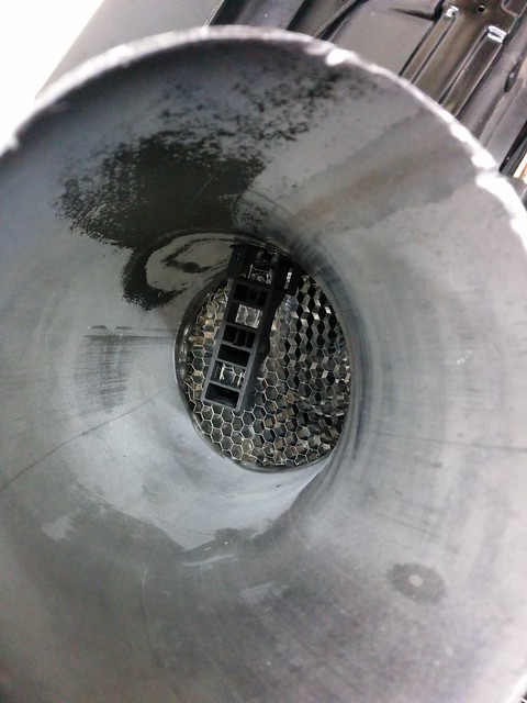

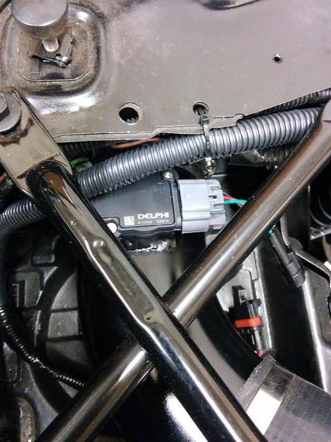

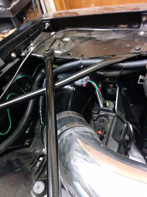

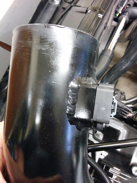

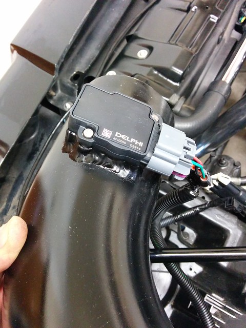

Just wanted to post up info about the Delphi 10056 MAF Sensor. I wanted a cleaner look and still use a MAF Translator. Yes I know XFI will get rid of the maf but I didn't have the $2k for the upgrade. I purchased a 4 inch pipe sensor mount off ebay and had it welded into my pipe. Mounted the sensor and connected the Translator. NO ISSUES! I also used the air straightener as it is just after a 90 degree bend. So if anyone wants to ditch there LT1, LS1 or Z06 MAFs, this is a good option.

Same as the LS1. Talked to Mr. Bailey and this is a replacement for the older LS1 sensor.
Looks like the new plastic LS1 MAF all stripped down. Nice install.
Yep that is correct!
What about the onboard IAT sensor......... Is it calibrated for our cars? Can it be used in place of our IAT
