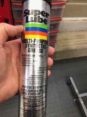

For those Rod end bushings use Super Lube it’s a PTFE (Teflon based) product available in spray, tube or tub form.
I personally use the spray for my rod ends, however use the tube installed in a gun for my zerk (grease fittings ) for the rest of the front & rear suspension
